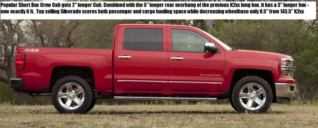

Crew Cabs are all 2" longer - going from 151" Bumper to cab length to 153"
In turn the Double Cab increases 1.5" from 141.5 to 143 - now we have 10" difference. Then the Regular Cab is stretched from 117" to 123" - now we have these 10/20" segments and get rid of the 14" wheelbase spread between the RC 6.5 and RC 8.
Then the boxes are 72" - 87" - 97" So in this system, the 163" Crew Cab has the 87" 7.25 ft box.

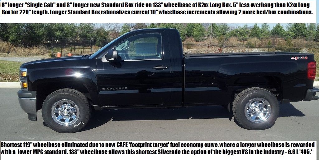

I'm preserving all wheelbases but the 119" - so 133, 143, 153 - and adding a 163" on top.
The 133" WB Single Cab Standard box has a 47" overhang for the 87" 'standard box.' Standard box 'cab to axle' increases from 41.5" to 49.5." Total length 220" - 5" shorter than previous RCLB.

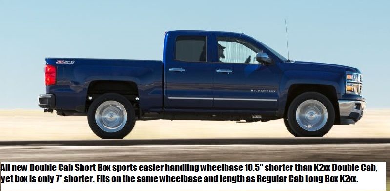

The 133" WB Double Cab with 72" short box has a 52" overhang. The wheelbase and length now exactly match the previous RCLB 133"/225"

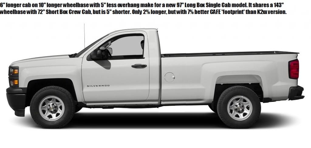

143" WB Single Cab LB has the 47" overhang, while the 143" CC Short box has 52" overhang. So the 133/143 wheelbases have two OA lengths apiece depending on cab/box.

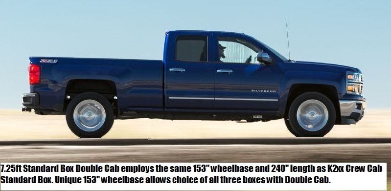

153" WB/240" length is the only 'unique' platform. It fits Double Cab with 87" 'standard box' only.

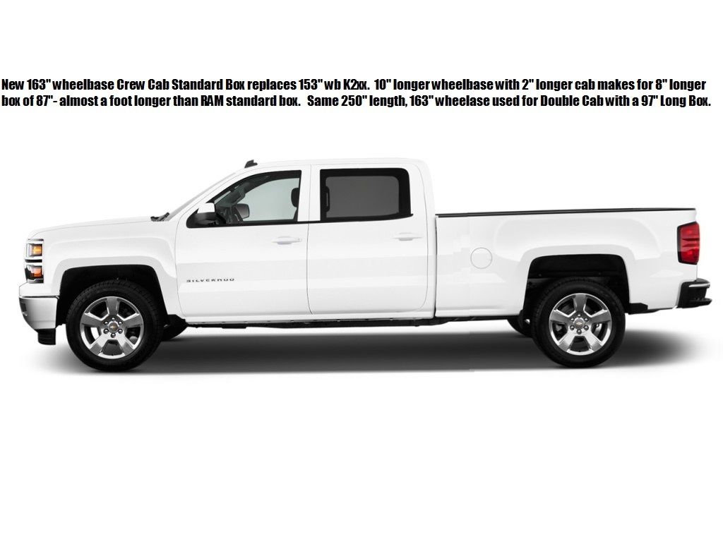

163" platform is 250" long (same rear overhang) for both 87" box Crew Cab and the 97" box Double Cab.

I think you are missing 1 important thing here which you will have to let me know in all these different numbers you are putting out. The question is which crew cab will fit in a garage??? My double cab standard box, which is the same as the crew cab short box, barely fits in my garage with only a few inches of space in the front and rear. May many people have this same dilemma and make purchase decisions based on size, because of the garage size used so much in homes. Thats why the crew cab standard box never took off and there is not that many out there.
Also I only like the looks of the single cab with the current short box, anything longer kills its proportions of looks imo.
You have a point there: The whole plan involves 'everything getting bigger' because then no cab is sacrificed to make it work. That had been the chief complaint of my other plan: no one wants anything to get smaller.
But the CC 72" box would still be 235" - 5" longer than it is now, but still 5" short of the typical garage length of 20ft or 240"
Also, the proportions of the "Single" or Reg Cab change because the cab grows 6" in length from 117" to 123." I was kind of making a compromise between the RC 6.5 and RC 8ft we have now.
But it is true that the 119" WB is being 'sacrificed' for the sake of lower CAFE standards enjoyed by longer wheelbase vehicles.
